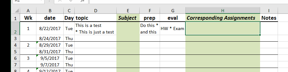

Here is the structure of my excel file. Week number, date, day of the week, the topics we’re covering, what the students can do to prep for class, what i’m going to evaluate them on (HW, exams), and notes about the assignment. Things in green are for my eyes only. Note the asterisk between items in the cells. The line breaks are for easy visual separation of items in a list, the asterisk will be used in code to create a formal html list.
