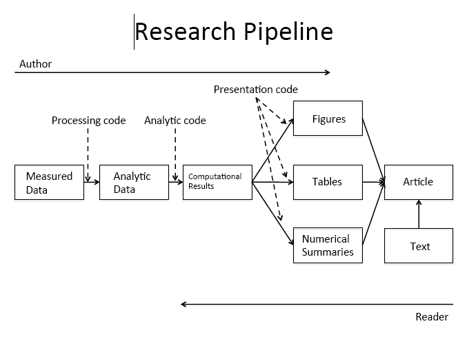

Reproducible Research
  • You are your own collaborator 6 months from now. Make sure you will be able to understand what you were doing.
  • Investing the time to do things clearly and in a reproducible manner will make your future self happy.
  • Comment your code with explanations and instructions.
    • How did you get from point A to B?
    • Why did you recode this variable in this manner?
  • We need to record those steps (not just for posterity).
  • This means your code must be saved in a script file.
    • Include sufficient notes to yourself describing what you are doing and why.
    • For R, this can be in a .R or .RMD file. I always prefer the latter.
    • SPSS users can open a text file or something similar. At each step be sure to copy the code from the program into this document.

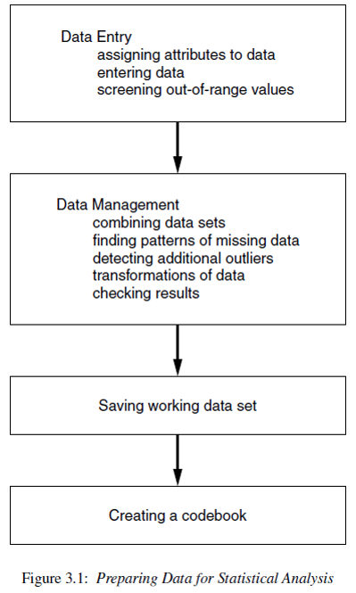

Data Management
Questions to ask yourself (and the data) while preparing a data management file.
  1. Do you need to code out missing data?
  2. Do you need to code out skip patterns?
  3. Do you need to make response codes more logical?
  4. Do you need to recode categorical variables to quantitative?
  5. Do you need to create secondary variables?
